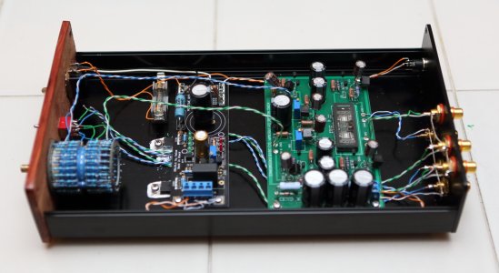

Reply #4 on: December 06, 2019, 03:35:44 PM
As Doc points out, it clearly needs a pre- and post-buffer.  It also provides 16dB of gain and you can fine-tune the distortion profile to dial up or down the magnitude of the second harmonic relative to the third harmonic as well as the phase of that distortion.  All in all, it's a very nice sounding preamp that provides quite a bit of flexibility for experimentation and learning!  I've been using mine for about a year and really enjoy it!  It sounds quite nice when driving a variety of Class-A mosfet amps that I have.
Eric

Reply #8 on: December 07, 2019, 03:53:42 AM
A form factor that fits a socket would be a nice feature - I didn't try before I soldered it in, but wonder if it would fit an IC socket?  I'm thinking I remember a 30,000 hr service life, but I might be wrong, its been a while since I've looked at the spec sheet.
At a total cost of about $120-150 for a completed unit (tube, board, components, chassis, etc), its a heckofa nice little preamp with a noise floor somewhere near -110dB.  The circuit that I used is here: http://www.firstwatt.com/articles.html
« Last Edit: December 07, 2019, 04:01:09 AM by EricS »
