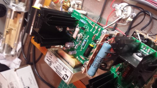

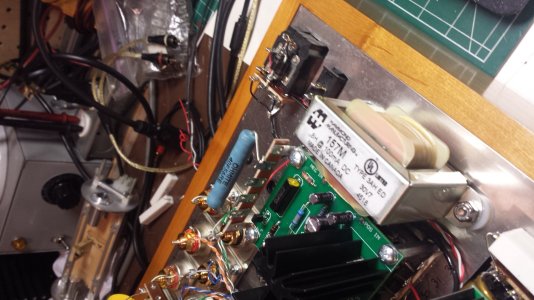

Not having the ability to leave well enough alone I installed a pair of Hammond 157m chokes in the power supply along with 56 ohm 10w resistors to keep the DCR at 300 ohms. and as Doc said in another post, I think all it did was add extra gravity and expense to the project (as I stated earlier the circuit is very quiet in its stock form) but they were fun to install and I didn't let any smoke out.
If there was an improvement it was minor, it didn't make it worse so I will call that a win.

I will attach pics of the choke install for others that want to make their Beepre's heavier and more expensive.

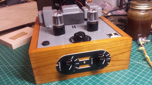

By the way loving my new S3x. Just ordered another yesterday and will use them as mono pair.
the one pictured has a BeeQuiet attenuator and 3 inputs and will be the master, the next will be the slave and have a single input from the master.
