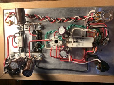

Here are some photos of the amp.

What part of the world are you in?  What was your measured wall voltage?  Which of the transformer voltages did you select for wiring?
All of this may have nothing to do with your problem, if there are wiring mistakes (like a backwards capacitor or diode), you could create the same problem, so posting some photos of your build would help too.

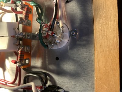

You have a miswire on the 9 pin socket.
Your amp had to have failed the glow test.  Half of the 12AU7 will not light up.

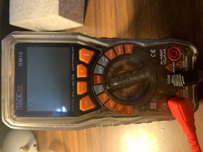

Please understand that I am a total nube. I’m posting a photo of the multimeter to make sure I am measuring with the proper setting. I used the alligator clips to measure voltage using the meter set to this setting and it initially showed a little less than 100 volts. I thought that was strange but I’m in the country, new house, just in the sticks.

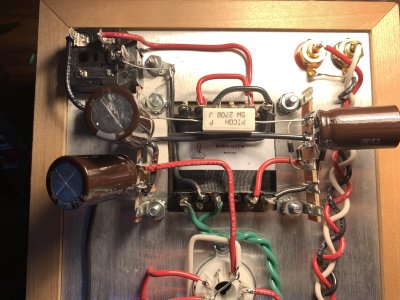

Photos

I’ve fixed the wiring to the 9 pin socket.

You've got the red meter lead plugged into the current ("A") socket of your DMM. You need to plug it into the one on the right with "V", etc.
A little more on this, the "A" socket is for measuring current, and there's a current shunt between that socket and the black socket that is a very, very low resistance component.  As soon as you touched that red probe to a high voltage terminal, that current shunt will blow your fuse immediately.
You're still missing a wire on your 9 pin socket.

Thank you so much.  That fixed my measurement issues.  My current at the outlet is 122 v.  I'm off to the hardware store, hopefully to get 1 amp fuses.  I'll rewire the transformer to match the voltage later tonight.

In your original pictures, the white wire on the 8 pin socket (nearest the transformer) is on the wrong lug.  Was this fixed?  As Paul wrote, it looks like there is a wire missing on the nine pin socket.  Every terminal on both sockets should have a wire attached.
