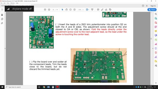

in the manual it says that the center lead and the lead under the screw were suppose to overlap. I missed this part and just had one lead in each hole. Is this going to be an issue?

Oh yeah, that will be an issue! You can use some little pieces of scrap component lead to make that connection.

Will do thanks PB!
