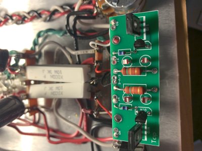

Can you post a photo of your board?  I would bet you have a PN2907 installed backwards.

Reply #2 on: December 26, 2019, 06:49:36 AM
I have to use my phone for photos. Sorry for the delay.

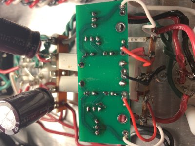

Are the LEDs on the socket illuminating?  Was the amp working properly prior to installing the Speedball?  Can you post a photo of the bottom of the PC board?
It's important not to make any guesses at this point, but rather to collect a complete set of information.
Offline Agweeks
    • Posts: 41
Reply #5 on: December 26, 2019, 07:15:47 AM
All leds light up. Amp worked fine before. Attached is the photo

Reply #6 on: December 26, 2019, 07:27:45 AM
All leds light up.
For every joint on the bottom of that PC board other than the ones for the LEDs, reheat them with your soldering iron until the solder melts, then count to ten.
The LEDs lighting up tell me that your tubes are glowing and that the board is passing some current.  The really low plate voltage in combination with the illuminated LEDs tells me that the amount of current passing through is very, very low, which is almost always a solder joint issue.

Reply #12 on: December 26, 2019, 01:02:34 PM
I would go ahead and give the LED solder joints on the board a bit of reheating as well.  Looking at the images again, I can see at least one LED joint that isn't all the way flowed.

Reply #13 on: December 27, 2019, 02:19:11 PM
As we discussed over the phone, I have a broken LED's on the 9 pin tube socket.  I've ordered more from you guys.

    • Posts: 20203
Reply #14 on: December 27, 2019, 03:08:28 PM
Just a piece of wire to connect A3 and A8.
