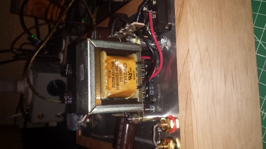

Offline Thermioniclife
    • Posts: 812
Reply #8 on: January 02, 2020, 04:32:09 PM
This is how I did it.

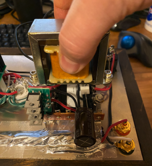

Reply #9 on: January 03, 2020, 02:04:44 PM
I have a piece of sheet aluminum arriving tomorrow.   I intend to cut and mount a sub-chassis using 1" standoffs on three of the power supply screws.   My intention is to mount it below the power supply, rotated 90* from Therm's mounting position.  The lugs on the choke will go front to back, rather than side to side.
Pic attached of me holding it approximately where I intend to mount it, and a mock up of the sub-plate.
I am open to input!
« Last Edit: January 03, 2020, 02:47:19 PM by Kermit »
    • Posts: 20260
Reply #10 on: January 03, 2020, 04:19:31 PM
If you start connecting the transformer screws on the bottom side of the amp with metal, you will likely cause some operational issues.  The solution is to either use nylon standoffs or use a piece of sturdy plastic instead of aluminum.

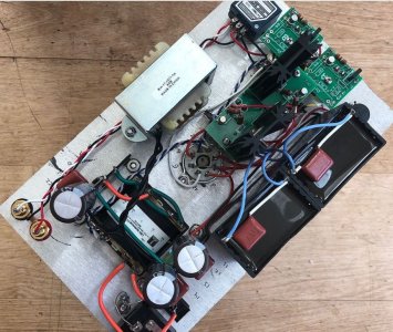

Offline fromnowon
    • Posts: 53
Reply #12 on: January 04, 2020, 06:23:27 AM
Thanks for the pictures!
The picture attached must be the location in the Headphonesty article.
- If you were to attach with tape, I suppose a ground wire would be necessary.
- If the choke is attached with metal stand-offs bolted to the plate, then no ground wire is needed.
Is that correct?

    • Posts: 20260
Reply #13 on: January 04, 2020, 07:25:38 AM
Is that correct?
Our preference is to control any potential magnetic eddy currents by isolating chokes and transformers from the chassis plate, then providing a separate ground wire back to the chassis ground lug.
