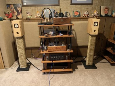

I'm working on a plan to power a sub with a small Sansui AU-222 I have.  The Blumenstein Orca's sound good but need some bottom.   There's a million ways to solve this but I'm going to try this.

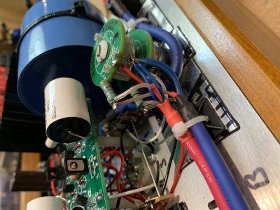

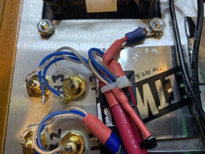

I only have one source and I'd like the Stereomour, Crack-a-2-a and the little Sansui to all use the same source.  I had built the Stereomour with a pass through on the 3rd "output".  The inside set of RCA's is attached directly to the input of the volume pot (or the output of the source selector - I don't remember which way I did it).  That way no matter what the other two inputs are on the 3rd set is always live.  I also don't need to have the Stereomour turned on to do this as the inputs are shorted via that connection directly to the output RCA's.
The Crack-a-2-a has three inputs...hmmmm…. ???
Not difficult unless you've had three cups of coffee prior to doing the work.   ::)  On the Crack-a-2-a I did attach the inside set of RCA's to the input of the volume.  It looked easier at the moment and it does work.  I left the wiring in place for switching the inside RCA just in case I wanted to change this later.
