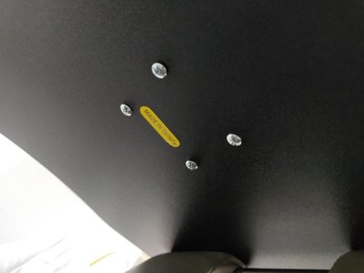

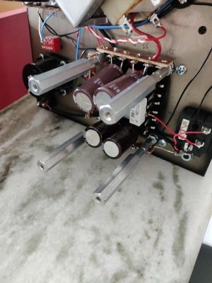

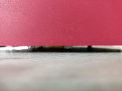

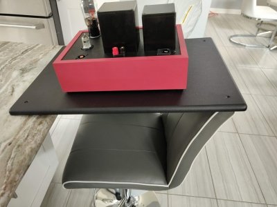

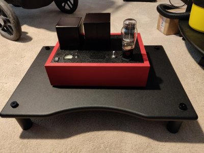

After a bit of trial and error I have finally managed to get my amps bolted to the amp stands so thought I would circle back around to share my learning and results.

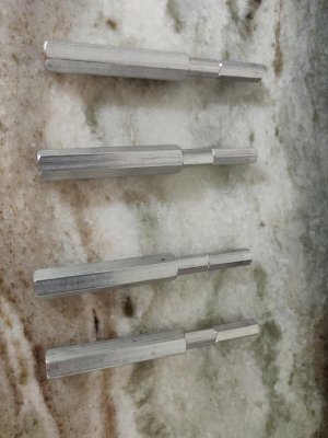

Took a few attempts at getting the right standoff length but what I ended up with (slightly ugly but functional) is a 2" F-F, 1/2" M-F and 3/4" M/F to give me a 3-1/4" F-F standoff. The gave me somewhere between an 1/8" and 1/4" clearance between the standoffs and the amp stand once installed on the PT-10 bolts.
I used 1" 8-32 pan heads to go up through the amp stand into the standoffs.
The first standoffs I bought were 3/8" HEX. I found 1/4" HEX much better when connecting to the PT-10 bolts as it all gets a bit tight around there with the terminal strips and a few cables running nearby.
The result is great. I'm not sure I would pick up the whole assembly by the wood base of the amp and rely on this arrangement to carry the weight of amp stand, but that shouldn't ever be really necessary.
Thanks everyone for the input and if anyone has any other questions please let me know.

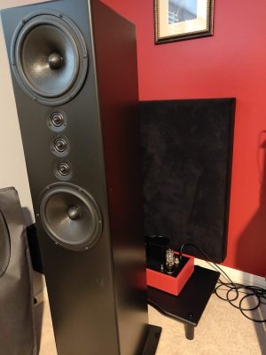

That looks GREAT!  I like the color matches and that the amp is tucked away behind the speaker.  This is likely to help keep it out of harm's reach.  Nice implementation!

Thanks for all the positive feedback. I'm really pleased with the overall result, and it really wasn't too bad to achieve. Best advice was using the chassis plate to mark the holes before starting the build, that helped no end and I was able to get the amp lined up right in the middle of the stand, which is really nice for my mild OCD on the back end.
Honestly the wood finishing was the thing I was most worried about. My previous build (Crack Amp) I didn't do anything with the wood base as I was too eager to start building and never got back to it. I did have all sorts of ambitious ideas from powder coating the chassis plate to getting a high gloss mirror finish on a red tinted wood stain, but in the end decided to go simple. There was no special prep beside ensuring the wood surface was clean. 3 light costs of standard household paint (left over from when the room was painted about 4 years ago in truth) using a smooth finish foam roller deems the results as seen.
It's a bit "eggshelly" up close (which I think can be seen in one of the pics). Ideally I would get some higher quality paint and spent the time sanding an refinishing to get a really smooth coat. And I did think I should get some matte lacquer to protect the paint over the long term, but for now everything is bolted down and I am enjoying the amps for what they were designed for.
