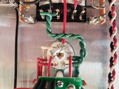

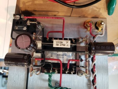

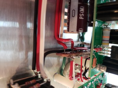

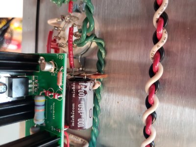

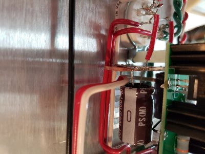

Hi PB. Something's up with a Crack I just built. Double checked all the wires and couldn't find any shorts or miswires.
Resistances
7: 5.62m
9: 5.62m
B3: 5.85m
B6: 5.85m
Last Edit: January 22, 2020, 10:14:40 AM by Jimb0
Jimb0
Sr. Member
304
Re: High resistance readings at 7, 9, B3, and B6
January 22, 2020, 10:11:18 AM
pics

I found the reason. I had one of the rectifiers on the wrong way...
Paul Birkeland
Global Moderator
20260
Reply #3 on:
January 22, 2020, 12:06:09 PM
If you want the resistances to be correct, you would have to remove the big Speedball board and put the 3K resistors in its place.
