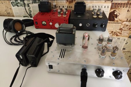

We have three evolutionary prototypes in house and we have listened to Nectar Sound, Stax and Koss ES headphones. They all work as expected. The chassis has taken a turn away from our usual flat panel in wood base approach. The bias voltage supply, while operating at a teeny current, is high enough voltage-wise that we felt it made sense to completely enclose the circuit in metal. PB designed the layout so that it could be done as a kit. It would be a pretty involved build with a lot of sub assemblies to build and test. We're spitballing the kit price at around $800-900. If we deliver the amp as a finished product we are probably looking at $1200+.

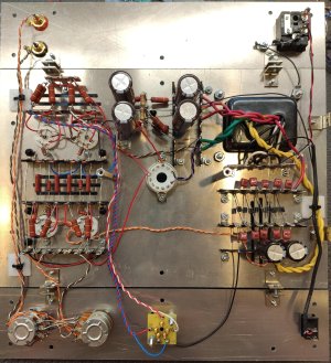

This is a rough idea of what the build would look like, but without the C4S boards that will be installed and a few other things. Not the most difficult thing to build, but certainly a lot more involved than a Crack with lots of p-t-p work that gets a bit tight. Derek is on the right track with his observation - how small a niche is DIY kitbuilders who use ES headphones and want a tube amp? Would the sales volume be worth it to make this only as a kit? If it is only sold finished we don't have to go through the huge amount of work that it takes to write an assembly manual. That is hard to justify if we are only going to sell half a dozen kits. But if a lot of bottleheads have ES headphones or plan to try them it's certainly worthwhile.
This stuff is hard to gauge. For example, one of the kits we stopped making for a while was our very obscure tape path modification kit. It sold quite well then tapered off after a while. I guessed that maybe the folks who wanted one all got one. But then we got so many requests for it we brought it back, and it continues to sell quite well. I guess I need to trade a kit for a crystal ball.
