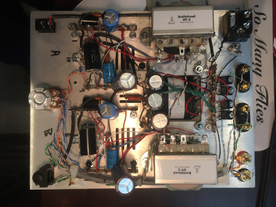

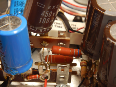

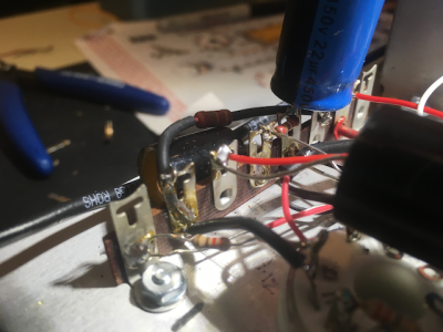

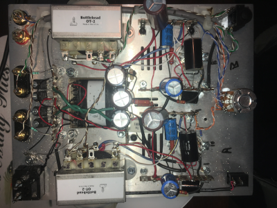

here's some photos: please let me know quality and quantity.  Trying to downsize photos to load better.
    • Posts: 20294
Reply #8 on: March 08, 2020, 08:04:50 AM
How about a top done shot that looks more like the one at the end of the manual?  (In a well lit room)

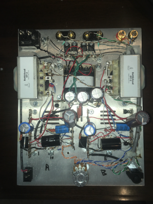

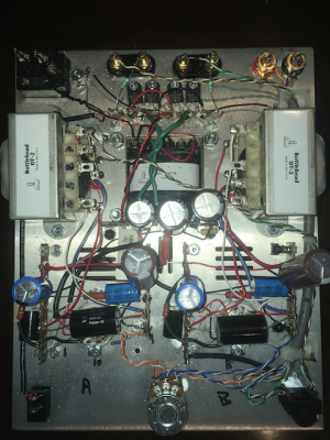

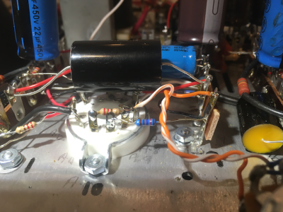

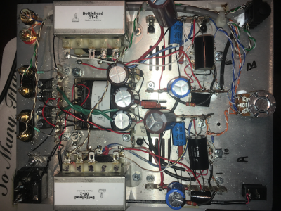

Reply #9 on: March 08, 2020, 08:32:33 AM
some with , some without flash
    • Posts: 20294
Reply #10 on: March 08, 2020, 08:39:04 AM
I would go ahead and do a voltage check on just that side of the amp.  That 680 ohm resistor is getting hot, but it's not smoking, so try to limit the amplifier on time to about 90 seconds. Once you perform those voltage checks, pull the 6FJ7 on that side of the amp and power it back up, then report the voltage on terminal 13.
It's still really hard to see much in those photos.  These photos are about 1/3 of a megapixel (a current cell phone is 48).

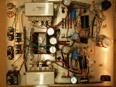

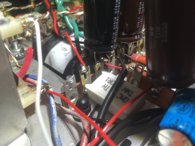

Reply #14 on: March 09, 2020, 05:12:14 AM
Any Better?
