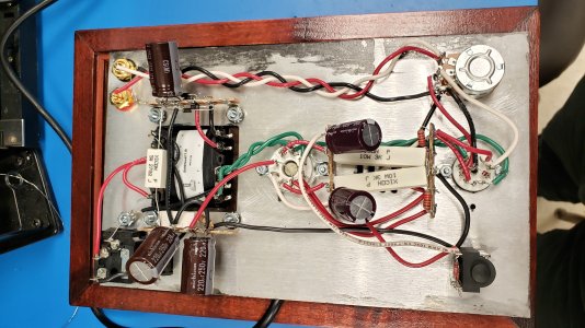

I recently finished building the stock crack and passed the resistance check and now am onto passing the voltage check. All voltages are correct except for terminal 1 and 7 which are 150V. I checked the LED connections at a3 ad a8 and get 1.5V for both of them, with both LEDs turning on. One thing I noticed is the 10k resistors being insanely hot to touch. Could anyone give trouble shooting advice? Attached are the voltages at each terminal and a picture of the wiring.
1 150
2 167
3 0
4 167
5 63
6 0
7 149
8 0
9 91
10 0

Reply #2 on: March 06, 2020, 12:45:42 AM
For starters, the red wire from A6 should go to T1 not T5.  Wiser folks will provide more incite.

Reply #3 on: March 06, 2020, 04:39:42 AM
That's about the long and the short of it.

Reply #4 on: March 06, 2020, 10:03:09 AM
Solved! Thank you so much guys!
