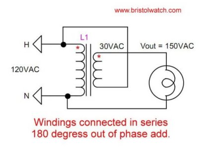

Another option is to grab a 120:6 power transformer and wire it as a boost transformer to kick up your AC mains voltage.  The transformer doesn't have to be all that big, a 6V/1A transformer would be enough to feed a BeePre.
