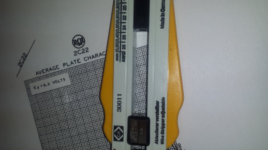

This is by far my most fav stripper for solid conductors, made by CK industries in Germany. there expensive but good.
I have used them for at least 10 years and are great for PTFE. Do not buy a Chinese knockoff that looks the same but is labeled OK industries.
