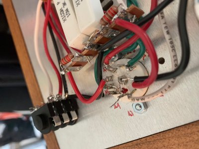

Yes, that's the part to get from Mouser.  Could you post a photo of the solder joint at A5?
Offline freejazz
    • Posts: 21
Reply #2 on: May 03, 2020, 02:01:13 PM
Photo attached. Thanks,
/d
    • Posts: 20297
Reply #3 on: May 03, 2020, 02:04:27 PM
On lower terminals, I would bend the wires up against the face of the terminal strip so they will stay put.  I would definitely do this on 2L.
The remaining HLMP-6000 needs its leads trimmed.
You can run a wire jumper from A3 to A8, then recheck the amp to see if the voltages at terminals 1 and 5 both settle to where they should be.

I will add the jumper after bending the all of the lower terminal strip leads up. As a quick note, in the current picture the LED and the wire from the volume pot to the center pin aren't soldered. I had unsoldered them to try and start fresh with the LED solder joints. I'll reply shortly. Thanks again.
