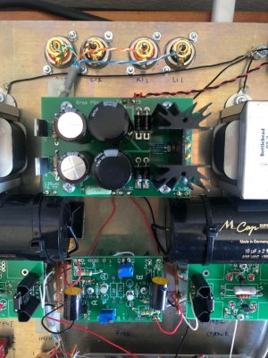

Just tested my voltages and resistances- everything seems to be normal except for the +275 VDC on the power supply board and the IA on both CS4 boards. Those voltages come back at around 250 VDC instead of 275. I'm guessing that's probably an issue...
I've attached a picture of that board for you guys to give me your impressions (it would be really great if I didn't have to disassemble the whole thing  :'( )
EDIT: The T4 and T5 joints look suspect to me... Gonna start with those...

    • Posts: 20278
Reply #3 on: May 06, 2020, 11:58:38 AM
What country are you in?  What is your AC line voltage?

    • Posts: 20278
Reply #5 on: May 06, 2020, 12:25:55 PM
Measure your AC line voltage.  If it's a little low, then having a slightly lower voltage coming out of the power supply isn't abnormal.  There is still plenty of voltage there for the high voltage regulator to be able to properly do its job.
I just measured the socket the amp is usually plugged into and you're right, it is indeed undervolted (it reads between 111-112 VAC.) I re-soldered those joints anyways just to make sure that wasn't a problem, but alas, it still reads between 245-250 VDC. Oddly though, now the Bregs read between 220-222 (I hope that's fine?)... Given what you just said though I guess I'll just buy some new tubes and hope for the best! :)

    • Posts: 20278
Reply #7 on: May 06, 2020, 01:50:41 PM
Yes, your line voltage is low.  Provided the power supply board puts out more than 225V, the amp should still work fine.
I would recommend checking the line voltage elsewhere where you are using the amp.  111V is very low these days, and there may be something else at work.
The highest voltage I seem to have in the house is 115VAC, and when tested there the +275vDC terminal reads 255 and the Bregs sit between 220-221 on the left and 221-222 on the right like in the other outlet. All other values are just like the manual. I live in an apartment unfortunately, so all I can really do about the low line voltage is complain to the manager. Hopefully there's nothing else at play and it's just the crappy line voltage.
