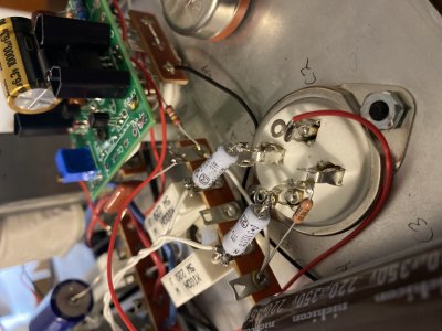

Is 5.6V ok to get on the 300Bs during the test? I assume so but it is outside of the range but a little over 10% so thought I’d ask

This is 5.6V at pins 1/4 on the socket itself? Are you using the 0.51 ohm resistors? Pics of the install?

It is on pins 1/4 on both the A and C side. I’ll post pictures in a bit. I don’t have the instructions in front of me, but I did use all available resistors from the kit.

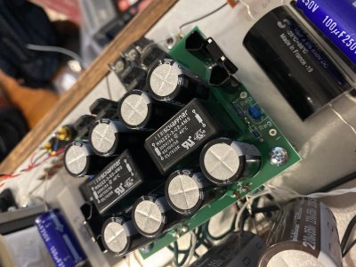

No, any autoranging meter should resolve 5V just fine. What voltage do you get on the terminal strips where the DC output of the regulator board lands?

B tube

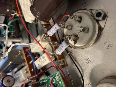

C tube

DC board

You have not properly installed the board.

You know, I went over those instructions about a thousand times and still managed to get that final step wrong.

For whatever reason AC In and DC out made a bunch of sense. AND I only had one IPA while doing it. Embarrassing.

Hokay. With the error fixed I’m within the right range on both tubes. I’ll let the caps discharge and go do some chores then see how it sounds.
