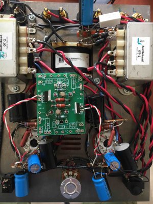

I have a Bottlehead S.E.X. amp. Bought second hand, hence I am not feeling comfortable yet to build a complete system like the S.E.X. amp.
When I attache the power cable (220v) there is a loud sound from the headphone: It sounds "like a dolphin". I instantly shut down the amp of course.

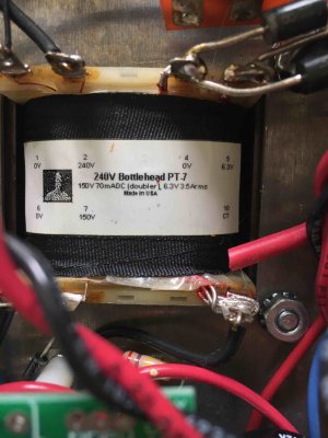

Does it have a 240V transformer or is it wired for 240V?
If you don't know, you can flip it over and post pictures of the bottom of the power transformer.

Hi, hope you can see the attachments for this!
    • Posts: 20300
Reply #3 on: May 22, 2020, 07:10:13 AM
Alright, so you have a 240V SEX amp, are you in a 240V country?
This noise could easily be external interference from a wireless device like a router or a cell phone, or a badly polluted powerline.
There's maybe a 0.1% chance that it's tube related.
