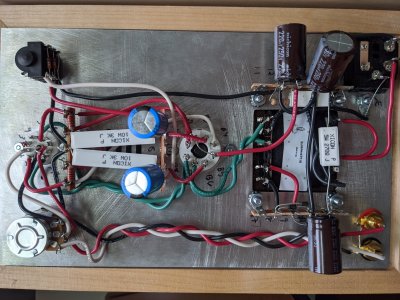

My voltage readouts are not right and my led's are not working. Not sure what to do from here. My voltages read
1. -1.2mv
2. -1.2mv
3. 0mv
4. -1.2mv
5. -1.2mv
6. 0mv
7. 4.6mv
8. 0mv
9. 12.9mv
10. 0mv
Any help would be greatly appreciated

Reply #6 on: May 29, 2020, 04:27:58 AM
And here's a picture of it just in case this helps.

Reply #14 on: May 29, 2020, 07:37:54 AM
It looks like you've got one diode of each diode pair going the wrong direction (one pair between transformer and terminal strip, the other on the outside of the terminal strip). The silver bands of each pair should be facing opposite directions. See pages 38-39 of the manual.
