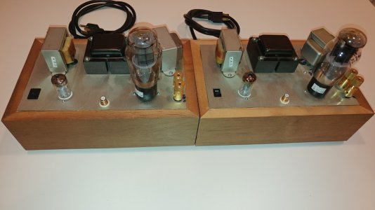

Got a pair of Paramour 1 (Hammond PT) from a friend. Love it. Want to upgrade the irons with the Iron Upgrade Kit for S.E.X. Kit 2.0. I noticed some owners also bought the C4S. Is this also a good upgrade option? What's its purpose and which version should I get? Thanks.

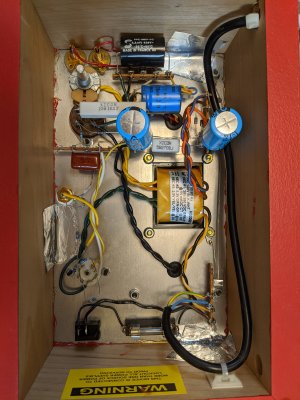

Do you not already have the C4S driver? Only the very earliest Paramours came without it, and many of them were upgraded as soon as the kit came out.
Perhaps you could post a photo of the underside of the chassis to help us know exactly what you have?

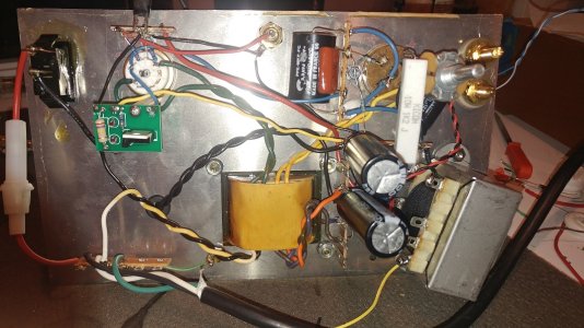

This is not 100% straightforward, but it's totally doable.  I'll attach the photos that I took the one time I did this.

Reply #3 on: June 02, 2020, 08:48:16 PM
Here's the photo.

    • Posts: 5898
Reply #4 on: June 02, 2020, 09:23:15 PM
Wow! That really is a pristine first-run Paramour! Beautiful construction, too.

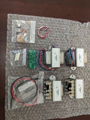

Reply #11 on: July 12, 2020, 05:17:27 AM
Hi Paul. Parts finally arrived.

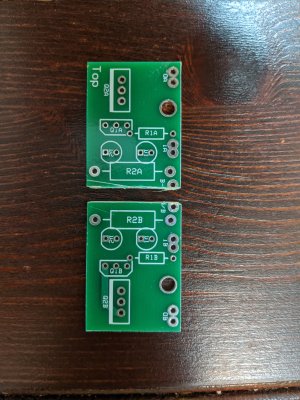

You'll need to buy a pair of tin snips, then cut the board in half right between the two solder pads at B-A/B.

Reply #13 on: July 15, 2020, 03:15:49 PM
Cut into two pieces.

Reply #14 on: July 15, 2020, 03:29:09 PM
You can stuff those boards with all the parts from the SEX C4S upgrade kit.  You will need a 1.5K cathode resistor for each amp.
In one Paramour, send the green twisted pair of wires to pins 4 and 9 on the 9 pin socket.  Wire the 1.5K resistor from pin 3 to ground.  Signal in from the RCA jack goes to pin 2.  Output of the C4S (the "O" terminal) goes to pin 1.  Pin 1 also leaves and feeds the coupling cap.  The "I" tab on the C4S board needs to be fed by B+ (ask if you aren't sure where that is) and G goes to ground.
In the other Paramour, send the green twisted pair of wires to pins 5 and 9 on the 9 pin socket.  Wire the 1.5K resistor from pin 8 to ground.  Wire the incoming signal from the RCA jack to pin 6.  Wire the "O" from the C4S to pin 6.  Pin 6 also leaves and feeds the coupling cap.  The "I" tab on the C4S board needs to be fed by B+ (ask if you aren't sure where that is) and G goes to ground.
Voltage on 3/8 should be about 3V.  Voltage on 1/6 should be about 180V.
