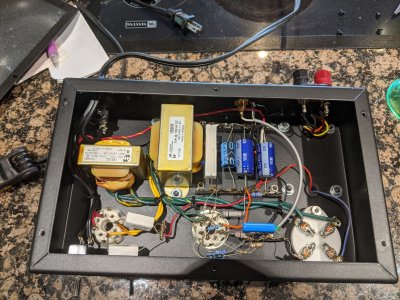

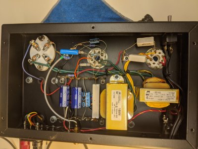

I'm not sure.  Attached a pic.

    • Posts: 20348
Reply #9 on: August 09, 2020, 07:38:27 AM
There's no hum pot and AC heating, you have to live with it, or you have to add hum pots.

    • Posts: 20348
Reply #11 on: August 09, 2020, 08:05:32 AM
It's not that hard.  The hum pot will have to live on the inside, so it will be a bit tedious to adjust, but once adjusted you can leave it till you get new tubes.  I would buy some 16-18 AWG buss wire to use to attach the outer pot lugs to pins 1 and 4 on the socket.  That will help immobilize the hum pot inside the amp physically.
Beyond just adding the hum pot, you need to pop off the green/yellow stripe wire and cap it with heatshrink so it doesn't touch anything, then run a wire from the center lug of the hum pot to where the green/yellow wire connected.
