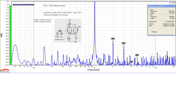

Without the DC filament supply, the mains AC frequency on the filaments adds little sidebands to whatever content the amp is playing.  These disappear with the addition of the DC filament supply, which I find to be a good thing, but it is something that sounds a bit different.  I've attached the first image I came across on Google Images that shows the appearance of sidebands.  These are way down because the DHT in question is running DC on the filaments.  They would be far, far more pronounced on an AC heated Kaiju.
Knowing Bartola that amp will be using Rod Colemans filament regulators, which are basically a regulated current source supply.
It sounds a bit like the Crack with or without the Speedball debate to me.  A regulated DC supply is going to clean up the amp considerably, yet some people just prefer the stock Crack.  Certainly with a harsh sounding source as its going to become all the more noticable.
