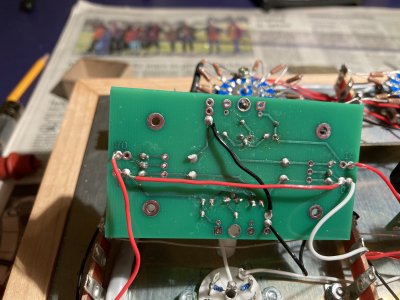

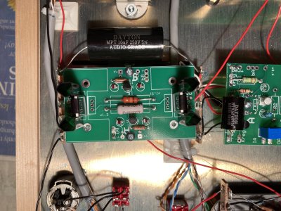

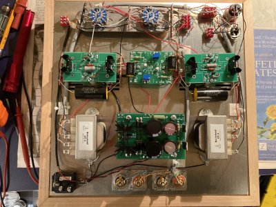

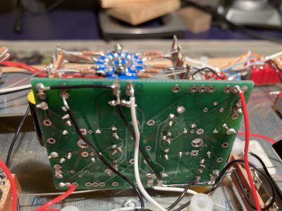

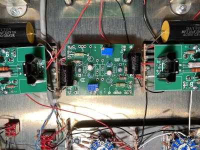

Here are some images:
1) The underside of the B-side C4S board
2) The top view of the B-side C4S
3 The bottom of the Reg board
4) Reg board top view
5) Overview of full mainline
    • Posts: 20278
Reply #3 on: June 06, 2020, 10:13:05 AM
In the first photo you posted of the high current C4S board, I would reheat all of those joints.  If you're using lead free solder, I would get leaded solder.  If you are using leaded solder, I would use more heat (45+ watt soldering iron or a station turned all the way up).
