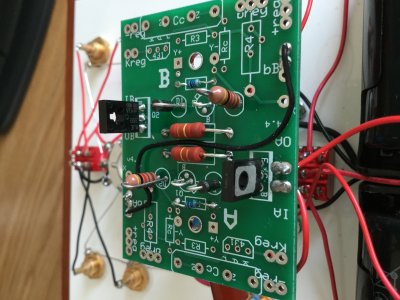

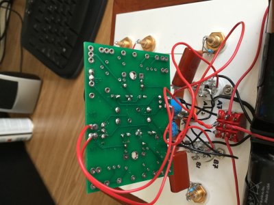

Reply #2 on: June 17, 2020, 08:01:09 AM
Hi Paul - a couple of pics attached.

Reply #3 on: June 17, 2020, 08:20:02 AM
You have a couple solder joints you could touch up. The A side MJE350 needs more solder, as does the smaller resistor near the B side.

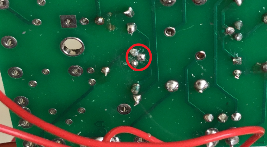

Reply #4 on: June 17, 2020, 08:43:08 AM
It looks like you might have a solder bridge -- see red circle.

Reply #5 on: June 17, 2020, 09:32:19 AM
You need to reflow all of the solder joints on that board.  Look at the A side MJE350 from the top of the board.  Notice how there's no solder wicking up around the transistor legs?  That's a 100% indicator that you need to reflow those joints and heat them till the solder flows through the board.
