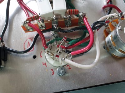

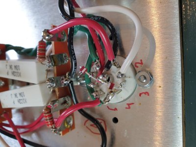

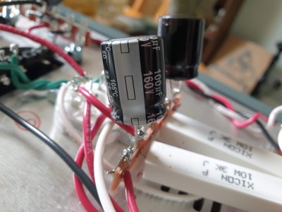

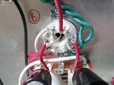

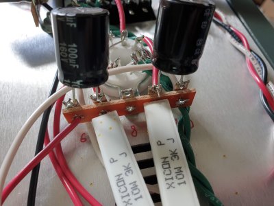

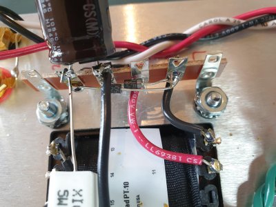

Hi
I have just "completed" my 1st crack build. Not there yet it seems! It initially passed all the tests on the "resistance tests" page 47 of the current manual.

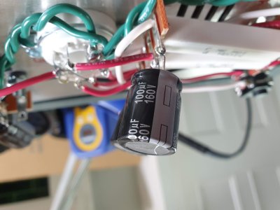

When doing the voltage check, there was a small pop sound/ electrical crackle and a touch of smoke, I believe from one of the 100uF, 160V caps on the side of the chassis closet to the headphone jack. This happened somewhere testing the tabs on the bar near the A socket. There are tiny flecks of brownish oil on the chassis, but I can't see a fault in the capacitor or anywhere else. I turned off/ removed the power, tubes, etc.

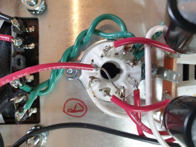

I have re-checked every step in the manual, checked all the wiring, etc. I have repeated the resistance tests and found that now, at B6 I get no resistance reading. It doesn't make a ton of sense to me (surprise, beginner) and I can't see anything clearly wrong.

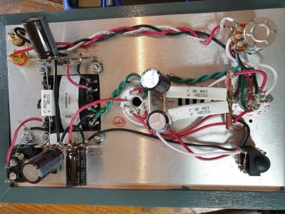

I have attached several pictures of the build to see what I have done wrong!
Tx
Chris

Also, assuming I need to replace those 2 caps at least, and I am in the UK, are these OK to use as replacements?
"100uF 160V Audio Note Standard Electrolytic Capacitor" (these are not expensive and they are available locally). Not sure why I can't post external links, but the name should do.

You'll want the designer, PB, to help troubleshoot this. But in the interim:
That's normal and harmless. It's flux from the solder. If you use a high flux solder like Cardas Quad Eutectic, you'll get a lot of those specks. They're actually hard - you can pop them off with a fingernail (but you don't need to - all of my amps have those everywhere).
Quote
It hasn't popped, so it might still be fine.
Quote
I don;t think the cap should affect the resistance reading at B6 - so I suspect a wiring/soldering problem. Do you still get a reistance reading of 2.9K at terminal 9? If so, the bad resistance reading at B6 points to a bad connection between B6 and terminal 9. Try reheating the connection of the red wire at 9 and add a tiny bit more solder.
cheers, Derek
Offline rat3hat
    • Posts: 27
Reply #3 on: June 21, 2020, 04:31:58 AM
Tx v much Derek.
"Cardas Quad Eutectic" - nailed it. Tx.
A bit more solder on B6 and that point it is reading fine now. All resistance and voltage tests pass now.

But just to be extra sure, I'd also reheat and add a touch of solder to the terminal 9 joint with the red wire. It's possible that the bad connection is in fact there and wasn't at B6, and that the slight movement of the red wire when resoldering B6 temporarily brought the red wire back into contact with terminal 9.
cheers, Derek

Tx very much, again. I have done just that, and touched up a few more points on the other capacitor and B3.

There isn't anything going on here that would lead me to believe you have a blown capacitor, definitely don't replace it.

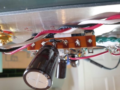

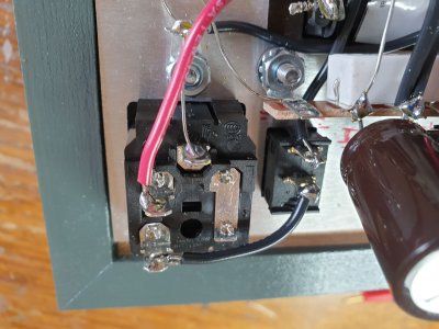

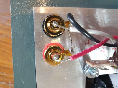

I have gotten back to the Crack project. All tests pass, but there was still a very audible hum/buzz. After searching the forum, I went back and reflowed all the solder joints in the amp. It still crackled, so I swapped tubes. It still crackles. I am using inexpensive low impedence headphones to see of "it works at all", so I don't plug in expensive headphones and hurt them. I did plug in a pair of high impedence headphones and the noice is VERY loud. Is the advice to reflow the joints again? Not sure what to do next. Pictures of the circuit are above, and happy to post pics of the reflowed joints if that helps.
    • Posts: 9780
Reply #11 on: June 27, 2020, 06:59:46 AM

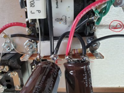

Typically background noise would get more quiet rather than louder with higher impedance headphones. The fact that it changed when you plugged in a different set of cans indicates that it could be a bad joint where the black wires connect to the headphone jack. This is a pretty common spot for a cold solder joint that causes noise.

Can you post some updated photos of your amp?  Looking over the ones you first posted, I see a lot of joints that never got adequate heat.  You need to heat your solder joints until the solder flows into them, and from what I see there are a lot of joints where the solder is just sitting on top of things.
Offline rat3hat
    • Posts: 27
Reply #14 on: June 27, 2020, 08:18:21 AM
Thanks again for reviewing my cack-handed work.  :-\ Perhaps when reflowing yesterday, I added too much solder at some points... not really sure. My soldering prior to this has been mostly DIY headphone cables and simple tube adapters. Whilst I practiced on simple tab strips also, perhaps I really just mucked up the soldering??  :'(
Here are some more pics.
