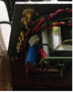

Reply #8 on: July 03, 2020, 07:58:30 AM
wonderful!  :D Here are the pictures.  Let me if you need me to take another shots

Reply #9 on: July 03, 2020, 08:47:24 AM
Those were the Chinese jacks that we were getting between about 2008 and maybe 2015.  The quality dropped substantially after a certain point and we switched to a different jack that fits in a larger hole.
This would be a pretty close substitute, though they are currently out of stock:
https://www.parts-express.com/parts-express-chassis-mount-rca-jack-pair--091-1120
If you want to drill out the holes in the panel to 10mm, you could install the Neutrik jacks we use now.
What's going on with the headphone jack?
Online Paul Birkeland
    • Posts: 20339
Reply #11 on: July 03, 2020, 12:36:17 PM
The first set of jacks you linked to are identical to what you have now.  Do be aware that the quality control issues could still be a big problem, and what we observed was that you couldn't tighten the nut on the jack enough to hold it in place without the threads disintegrating.
