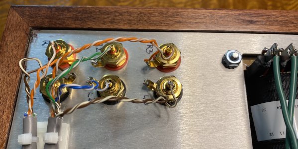

I thought this might be the case, too.  So, I rearranged the cables, keeping them away from anything that might induce hum.  Still there.  Tried different cables.  Still there.  Disconnecting them completely.  Still there.  Shorting the inputs.  Dead quiet.  Most prevalent in the jump from -9dB to 0dB on the coarse attenuator.  Then, each step on the fine attenuator accentuates the hum incrementally.  Wondering if I've got a grounding issue inside the amp.

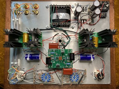

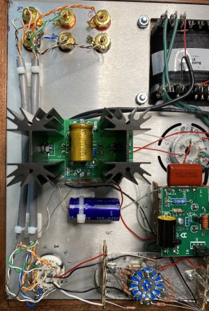

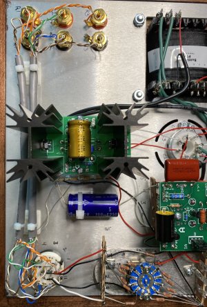

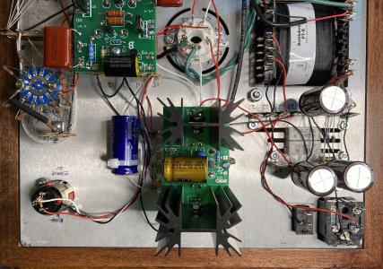

You could always post photos of your build.
Offline jtori
    • Posts: 125
Reply #6 on: June 29, 2020, 05:56:14 AM
Thanks, Paul.  You're right.  :)
    • Posts: 20300
Reply #7 on: June 29, 2020, 06:16:13 AM
Did you have this issue with the stock level pot and balance pot?

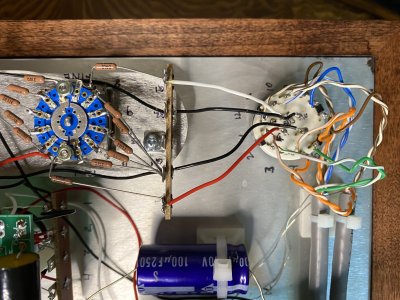

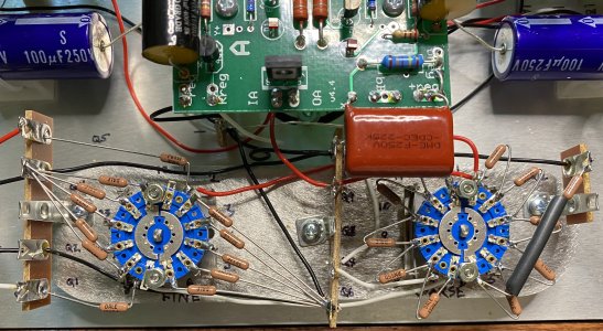

I would reflow all of the joints on the attenuator upgrade where a black wire lands.
If you have the fine control all the way up, is that the noisiest spot?
    • Posts: 9793
Reply #10 on: June 29, 2020, 08:08:00 AM
Are you sure it's 60Hz and not 120Hz? Does the amp sit near another power transformer, like on a shelf above or below it?
Deke609
Reply #11 on: June 29, 2020, 09:23:04 AM
For Q2, Q4 and what looks like Q12 (at the 2 terminal strip on the far side of the coarse), maybe pull the black wire out a bit and/or trim off a bit more of the teflon jacket. From the photos, it looks like the wire insulation extends into the joint.
cheers, Derek

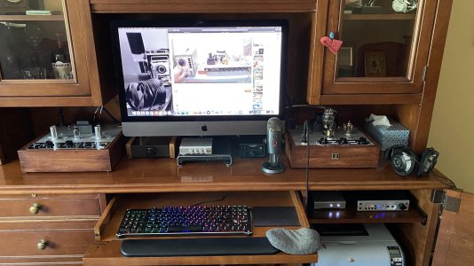

I feel confident it's a 60-cycle hum.  I'm fairly meticulous about keeping components and cables separated.  To be sure no transformers I unplugged all the wall warts powering peripheral devices.  While not near the amp, they share the same circuit.  On the outside chance it could be tube related, I swapped out the input and output tubes with others I have on hand.  For reference, I've attached a photo of my setup.
Could the computer be causing this?  My Mainline is dead quiet, as are my other amps.
Or, might this be something ground related?
Or, since the increase is most evident in the step from -9dB to 0dB on the coarse attenuator and is louder in the left channel than the right, could it be related to a resistor?
Yes.  When the coarse and fine are all the way up, it's noisiest.  I will do as you've suggested.
