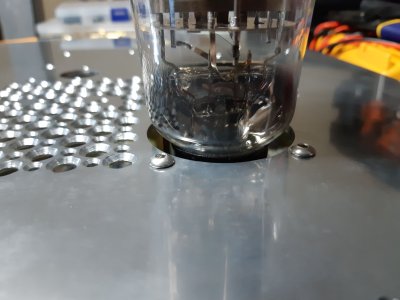

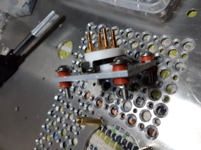

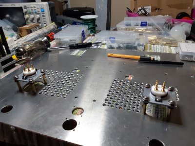

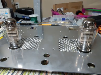

I've finally gotten around to the final rebuild of my Beepre in a huge aluminum chassis (that I call "Bigby", as in "big bee"). One of the challenges was figuring out how to deal with the extra height of the chassis - with feet and tubes installed, it wouldn't fit my rack. So I figured I'd make big cutouts for the tubes and install the sockets about 1"+ below the top plate.  And then it occurred to me that I could mount the socket subplate so that it is sandwiched between thick silicone washers: bolt head, steel washer, silicone washer, subplate, silicone washer, steel washer, standoff.  To minimize (hopefully eliminate) vibration transferred from the bolt threads to the subplate, I wrapped the top 3/4 of the threads 2-3 times in electrical tape -- just in case the side of the bolt makes contact with the inside of the subplate mounting holes.  I'm hoping the combo of ptfe sockets and the additional damping will give the 300Bs extra isolation from any chassis vibrations.
Here's some pics. I punched the silicone washers out a sheet of 3/16 silicone.
But it occurred to as I was putting it all together that a simpler and better approach would have been to really oversize the mounting holes on the subplate and install thick silicone/rubber grommets. Ah well ... next time.
cheers, Derek

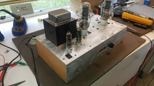

I have a suspended sub plate that the 300Bs hang out in.
Deke609
Reply #4 on: June 28, 2020, 05:39:59 PM
That's pretty cool. And single power trafo (Kaiju?) for a more compact layout.  What's that toggle switch for? Pre-heating the 300B's?

On further thought, I don't think my silicone washers are going to do much. I'm no physicist or materials engineer, but my gut sense is that the silicone is too rigid to do much damping for such a light mass load. I think I'd need a material with a consistency closer to partially set jello -- that, or suspend the tube socket subplate in a thin silicone web (think thin rubber bands).   But that would pose challenges for inserting/swapping tubes.  And it would probably work best if you could suspend the tubes upside down so that they don't fall to one side. If it could be made to work, that would be one really weird looking amp.  I'll likely never know.
