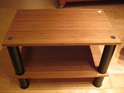

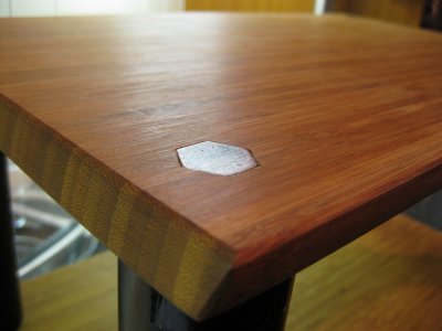

My IKEA special.  APTITLIG Kitchen Chopping boards, and some wardrobe feet joined together.  I have since added another level to it, may not have the surface area you need, but its strong enough to stand on.

Thanks mcandmar. That's pretty close to what I was originally hoping to do -- except I need a 7' tower. (My rack, which is for headphone use, isbeside my bed - first 30" from floor is for storage, next shelf serves a bedside table for books/glasses/keys and things I'm too lazy to put away, and from there up shelves for the components).
The IKEA cutting boards look pretty and good and the price is right. But the size is not. I need something about 22" x 18".
