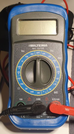

Hi, Ive got the same problem, so instead of making a new thread, Im posting it here.
When I plug the power cord to the wall socket, it makes my multimeter go haywire, + and - in voltage and around -7 to +7 and its never stable. I used both alligator clips and tried without, same result.

Just a couple shots in the dark: double check that (a) the meter is set for AC voltage, not DC voltage, and (b) the red lead is plugged into the Volts socket of the meter, not the Amps socket.

Im thankfull for your shots in the dark, they where correct! I didnt set my multimeter correct... damnit, thank you so much!

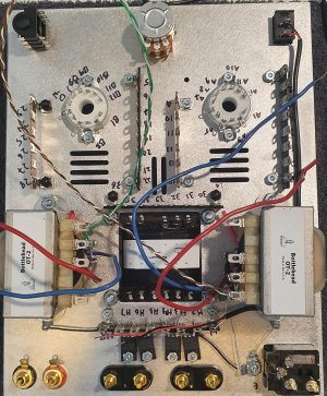

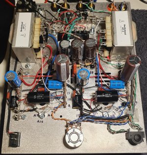

So Ive built it, and Im getting a couple of wrong voltages during the last safety check.
The measurements that are wrong are:
Terminal 16: 336v (should be 65-95v)
H4: -2v (should be 2.8 - 3.2v)
H7: -2v (should be 2.8 - 3.2v)
What causes this?
Edit: Some places where the * sign are at the measurements my multimeter give unstable readings, but if I understood correctly, thats ok?
« Last Edit: August 02, 2020, 04:34:40 AM by pofofo »
    • Posts: 20203
Reply #4 on: August 02, 2020, 06:13:36 AM

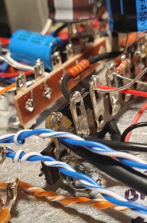

You may need to post photos for us to see why terminal 16 is high.  This is likely to be a poorly soldered component or a miswire.
H4 and H7 may show 2V if your meter doesn't have a low DC range.  What meter are you using?
Offline pofofo
    • Posts: 42
Reply #5 on: August 02, 2020, 06:20:44 AM
Thanks for the quick reply.
Its a very cheap basic multimeter I bought some years ago.
Edit: Terminals H2 and H5 measured 3v, H4 and H7 measured -2v

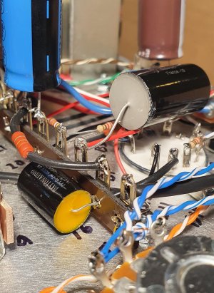

I would suggest reheating all of the solder joints on all of your terminal strips, especially the lower joints.  The solder needs to flow into the terminal strip, not ball up on the outside.  If you are using lead free solder, it may help to get leaded solder to make this easier.  If you have an adjustable soldering iron or soldering station, turning the temperature up all the way is also helpful.

But, the heat! I upped the soldering station and reheated all the lower terminal strips, and wouldnt you know it, Terminal 16 now has 89v.

You should be able to get a lot more resolution on that terminal than just 2V.  I would set your meter to the 20V range and recheck those and let us know what at least the first decimal point is after the 2.  +/-2.9V would be fine, +/-2.1V would not.
Offline pofofo
    • Posts: 42
Reply #12 on: August 02, 2020, 05:25:53 PM
Im such a massive noob. With the multimeter set to proper measurements, so I can get DECIMALS, the H4 measures 2.98v & the H7 2.97V.
