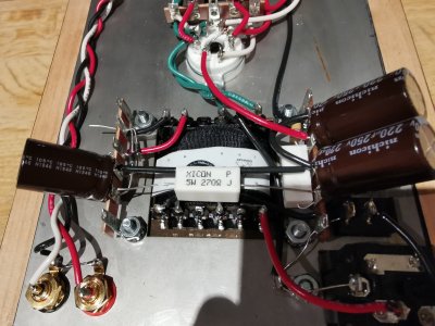

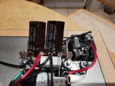

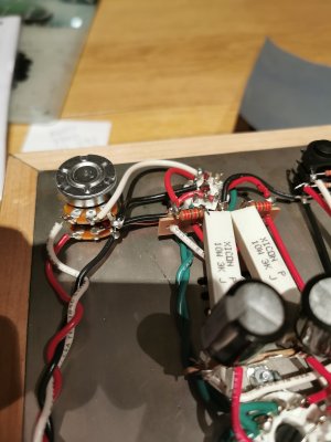

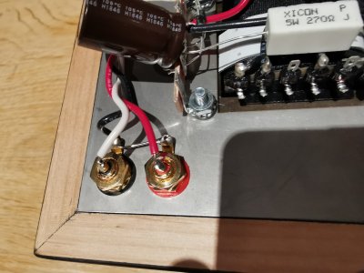

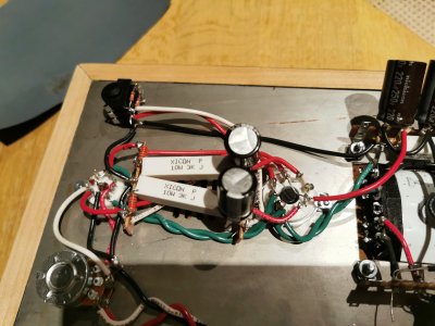

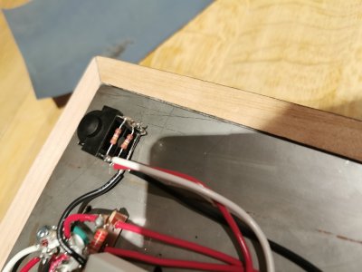

i just finished the crack a few days ago, test all passed, today i finally tested it, buzz / humm sound on right channel, if someone can help me, or may know what i did wrong, did reheat/solder already and added a little more solder (no change, still buzz / humm sound). pictures are attached

I would start by trimming those long leads that are poking out of your terminal strips, as those can cause some serious problems if they are left in place.
Is the hum and buzz there with the volume pot turned down all the way?
Can you post your voltages for terminals 1-10?
