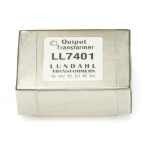

Hi there,
Has anyone tried to replace the output transformer (OT3) with the lundahl ll7401?
I'm planning to replace it. I don't know how the sound improves

A 1:1 output transformer is going to make the Mainline sound much, much worse.

Thanks Paul,
Would you like to give me ratio output transformer?

I would use what we provide in the kit. I have not run into any other suitable output transformer that will drop into the Mainline circuit and work just as the originals.

This is a bad idea. I don't understand what the original reason for changing it was. The OT-3 is designed specifically for this application.
