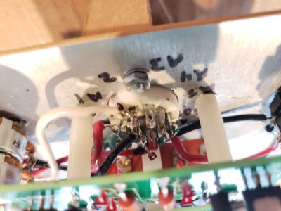

Build photos?

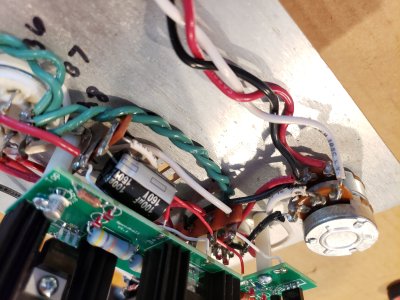

Took some photos of the build. I will try another 6080 soon
    • Posts: 20260
Reply #9 on: August 25, 2020, 09:55:53 AM
In your first photo where the black wires meet, I see one that isn't soldered.  There are some other suspect joints here and there as well.
I would recommend removing the Speedball and debugging the stock circuit if you are able to rule out tubes as the cause.

Reply #11 on: August 25, 2020, 01:40:51 PM
PB thank you. Definitely those terminals that needed soldering. Everything is working fine now. Appriecate the help, always
