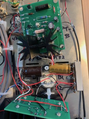

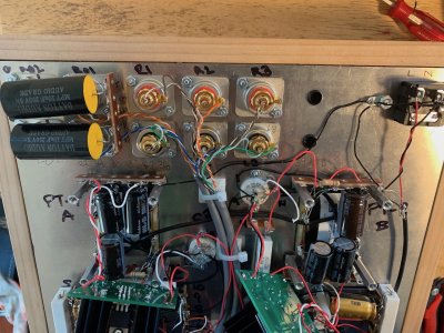

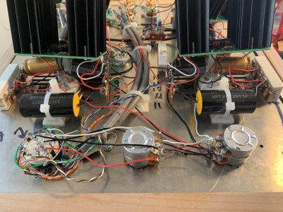

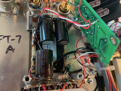

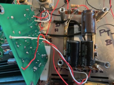

Is one of the 10,000uF caps mounted by the 4 pin sockets in backwards?  Can you post a bunch of build photos?
Both sides of your build have issues.  On one side, the 300B is operating correctly but the high voltage regulator is not.  On the other side, nothing is really working properly.
Offline taffet
    • Posts: 16
Reply #10 on: August 28, 2020, 02:03:09 PM
Hi Paul-I believe the 10,000 uF caps are installed with the correct polarities. Please let me know if you need some other views. Thanks so much for your time and essential help! Michael

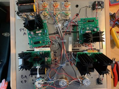

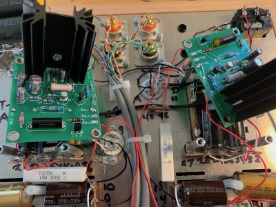

Offline taffet
    • Posts: 16
Reply #11 on: August 28, 2020, 02:16:04 PM

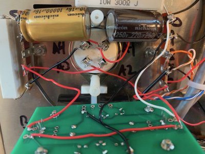

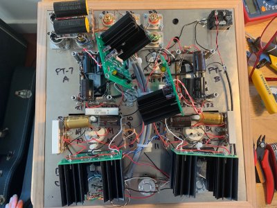

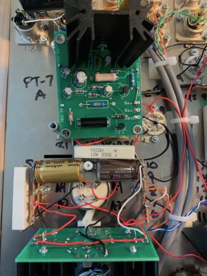

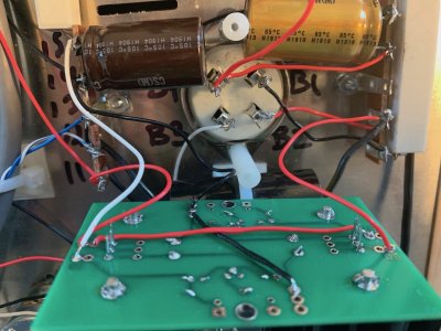

Two more photos......
Deke609
Reply #12 on: August 28, 2020, 02:55:09 PM
Hey Michael - What soldering iron are you using? What wattage is it?
I ask b/c you have A LOT of cold and flaky solder joints.
Subject to what PB says, I think your fastest route to a working and reliable amp is to pop all the boards off and reheat/resolder every solder joint. It won;t take as long as you think.  Use more heat on everything except the little red LEDs.  And make sure the soldering iron tip contacts both the wire and the terminal/lug at the same time, give it a second or two to heat up and then zap it with some solder - applying the solder to a contact point between wire and terminal/lug (not the soldering iron tip).  For terminals with multiple wires, I usually need to come at the same joint multiple times from different angles to make sure all wires/leads get heated directly.
Although this sounds like it will take forever - you'll be done in an hour or two. Trying to chase the problem a la "Maybe it's this wire, or this terminal, etc." could take days and possibly a lot longer.
Not what you wanted to hear, I'm sure. But I really think this is the simplest solution.
cheers and good luck, derek
    • Posts: 20302
Reply #13 on: August 28, 2020, 03:00:07 PM
In the very first picture on the bottom of the PC board you have flipped up, I see multiple joints with no solder at all and no leads trimmed.  I also see a broken white wire between one of the power supply boards and a 9 pin socket.
