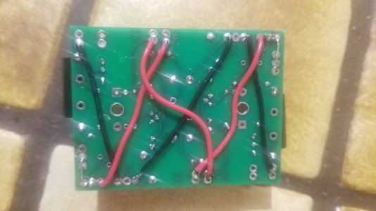

Reply #4 on: September 12, 2020, 09:07:56 AM
OK, Here it is again.
For now, seem to be having the same issue. I haven't done the voltage check again because I have a couple of LEDs that are not coming on. If all of the LEDs are not on, is it safe to check the voltages again?

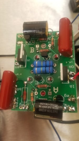

Reply #12 on: September 13, 2020, 06:15:50 AM

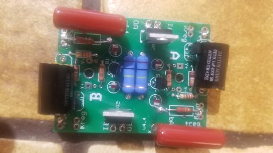

OK, that board had checked out OK, so it is possible there was a bad solder joint or something. I reflowed solder in most places. Here's where I am now:
« Last Edit: September 13, 2020, 06:17:30 AM by brianbuntz »
    • Posts: 20348
Reply #13 on: September 13, 2020, 06:56:27 AM
If you look at R1 on the A side, see how we can see down into the board around one lead of the resistor?  That's a textbook solder joint that hasn't been heated enough.  The solder needs to flow through the plating on the inside of the holes on the PC board.  I would reheat all your joints and heat them until you see the solder suck down into the joint.
The one exception to this would be the solder joints for the LEDs, as generally there is so little material to heat with the LEDs that the solder joints flow almost instantly.
