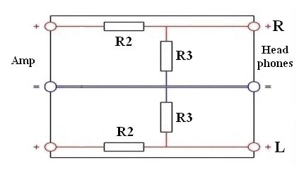

It's hard to stuff more than about 2V into any Grado headphone I've seen before it gets unbearably loud.  That would be about 1/2W of the 3.5W available from the Stereomour.
I would suggest running the amp at 8 ohms and wiring in a pad between the speaker outs and the headphone jack, with perhaps a 6 ohm R2 and a 2 ohm R3 as shown in the drawing that's attached to this post.  Increasing R2 and decreasing R3 decreases available output but also reduces the noise floor.  Decreasing R2 and increasing R3 increases available output but also brings up the noise floor.  R2+R3 should roughly be equal to 8 ohms.  The effect of adding your headphone's impedance in parallel with R3 typically won't throw off the value enough to be all that important in the grand scheme of things.

Looks simple enough.  Might be a nice sub box project.  Not sure I understand the horizontal lines above and below r2.  Aren't those redundant connections?

I don't know why those lines are there either, I would ignore them and not put them in.
