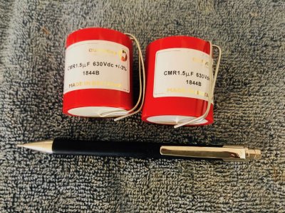

Offline Ivan303
    • Posts: 128
Reply #9 on: November 03, 2020, 07:14:47 AM
New parafeed caps are in house.  Not THAT expensive, about the price of the C4S mod.
Let them cook overnight and...
Pretty good!!!
Streamed Royal Liverpool Phil./Petrenko's new 'Petrushka, a really good recording with lots of individual instruments highlighted across the sound stage and...
Originally looking for a tube headphone amp capable of doing double duty with the horns as I upgraded the 300B monoblocks that are getting long in the tooth.
Now I just might build a second S.E.X amp and bi-amp the horns and maybe go to active x-overs.
