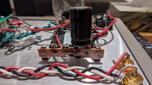

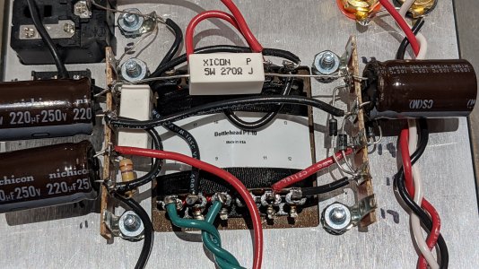

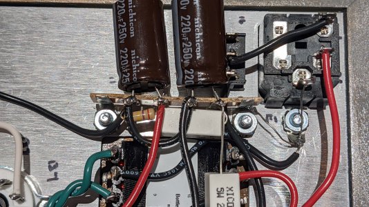

Here's the overly long story: I built the Crack stock first, and used it with no problems for two weeks (was really surprised and impressed with how it sounded!). I then installed the Speedball, which worked fine for a few days aside from a hum in the right channel only when RCAs were plugged in. Decided to take a look into the hum issue, see that the sleeve of the black wire from 3U to the headphone jack was frayed a little, so I replaced it with a new length of wire. Powered up fine, but the hum was still there, only a bit quieter. Went back again and resoldered some connections that looked iffy. Found the UF4007 going from 18L to 21L was loose, so I resoldered that. Powered on, and nothing. No voltage readings whatsoever. See the fuse is blown (the little wire inside was broken, I've never worked with these fuses before). Change the fuse, notice the leads of the rectifier I resoldered were touching the other UF4007 going from 18L to 20L, so I bent them back apart. Power on, fuse blown instantly.
After checking some resistances, I've noticed that I'm getting very high resistance at B3 and B6, as opposed to 2.9k ohm, and terminal 3 now has very low resistance. I don't know if that's from the Speedball or something I did. Most every other terminal, including the Speedball boards, read as they should.

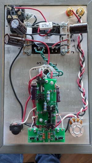

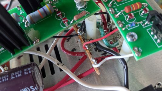

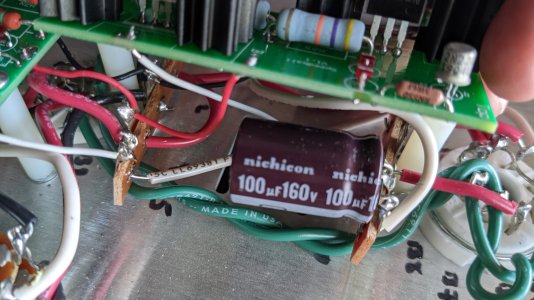

I should add I'm very new to this. The Crack is the first thing I've done...ever. I've never soldered, never worked with electrical bits, never even sanded and stained wood before. I had no idea how to use a multimeter, and frankly still don't. So it's been a learning experience to say the least. And unfortunately, this problem is beyond my extremely limited capabilities. I've attached a picture, as well as some closeups of 3U. Can anyone please offer some advice? Thank you!

I see a lot of long leads still and a bunch of leads that need to be trimmed.  What kind of fuse did you replace the blown one with?
The resistance at 3 should be 0.
The resistances at 7 and 9 will not be 3K because you took out the 3K resistors and put the Speedball in.
A fuse that blows immediately when you turn the amp on is either not rated for sufficient current, you have things touching that shouldn't be, or a component is in backwards.

The next test I would do is to remove the red wire from power transformer terminal 11, then see if a fuse will hold.

I would go ahead and replace all your UF4007 diodes.  It's possible that one has been damaged by the incidental contact earlier that was causing problems.  The fuse holding means your power transformer is OK.  That information combined with the fuse not holding when the wire leaving 13 is removed means there's a short in the high voltage supply somewhere.  You may find that terminal 13 shows 0, 270, or 540 ohms to ground?
