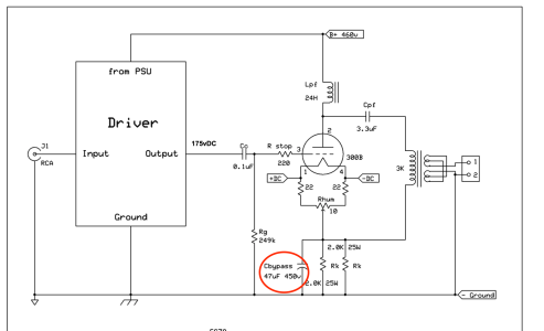

RE Something silly like a disconnected cathode bypass cap: In this case, would that be the 47uF 450v cap between terminals 5 & 10? (see attached) I can only "kind of" read the schematic. Any guidance on which cap to target is helpful.

I'm not saying it's the cathode bypass cap, I'm just giving an example of something that could be disconnected and would cause substantial sonic problems, but would otherwise leave the DC voltages alone.

Yes, it's the electrolytic cap mounted by the 4 pin socket.  It's not just the cap itself, but any wiring going to and from the output transformer would have the same effect.  A loose coupling cap could do the same thing.
