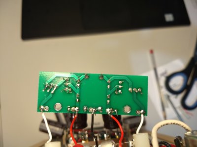

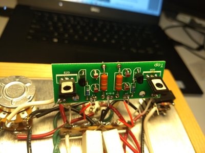

I soldered and resoldered/reheated all the connections in in the small board three times (photos attached)
Can I please have some advice on how to resolve this issue?

I would put the 22.1K resistors back.  You need a far, far better set of end cutters to cut the leads closer to the board.  I recommend the CHP-170.
The IA and IB voltages have nothing to do with the Speedball boards themselves, so seeing 0V there would make me believe that there's an issue with your build aside from the Speedball, so you need to go back to the resistors and debug the original build.

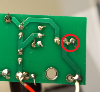

It looks like you might have a solder bridge on that board.  See circled area in attached pic.
cheers, Derek

Derek, thanks for pointing this out, I reinspected the small board and there is no solder bridge. It appears like there may be one in the photo due to the angle the photo was taken.
