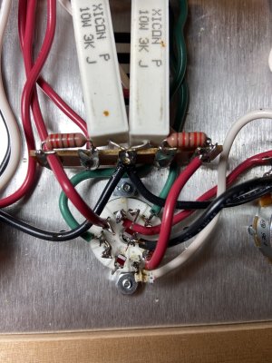

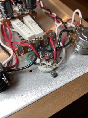

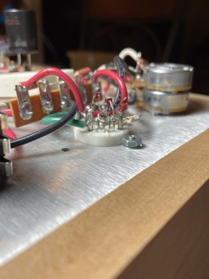

How about the 9 pin socket?
If you had said you had no sound from the right channel, I would say that the insulation is melted on the red wire going from the volume pot to the 9 pin socket, and it might be shorting out to where the black wires connect to the volume pot, but I don't see any issues there for the left channel.

I'm having some issue uploading photos. I modified my previous message with my 9 pin socket pics.

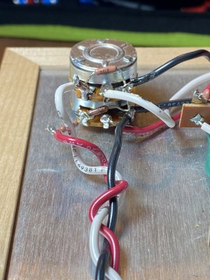

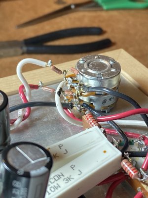

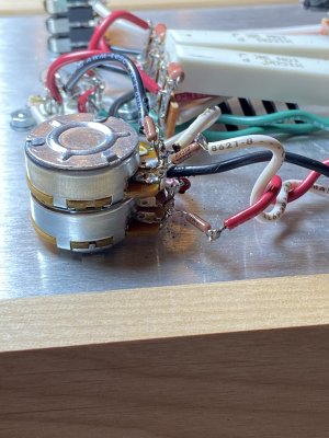

    • Posts: 20349
I would temporarily solder in a jumper between the upper and lower middle lugs of the volume pot, then let us know if that changes the behavior of the amp.
If it doesn't, remove that jumper and install it between 6U and 10U, then let us know if that changes anything.
