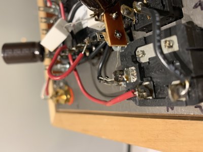

I have ordered the diodes and a solder wick. Based on the picture and what I can glean from the thread on this modification, is it simply a matter of removing the buss wire from the chassis ground and the 3-prong electrical ground and then soldering in two, twisted diodes between the two grounds? And the other half of the buss wire remains connected between the chassis ground and the connection labeled as #13, right?
    • Posts: 20260
Reply #12 on: December 09, 2020, 06:20:08 AM
Yes, that is correct.

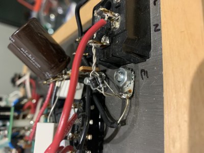

And remember to "reverse parallel" the diodes - i.e., have the marked bands of the diodes at opposite ends before twisting the leads together.
Offline Nignoog
    • Posts: 57
Reply #14 on: December 09, 2020, 08:47:57 AM
Thank you for the tip! I see that in the picture now. I would not have done it had you not mentioned. You saved me a serious headache!
