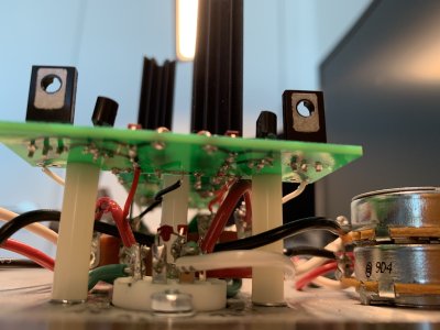

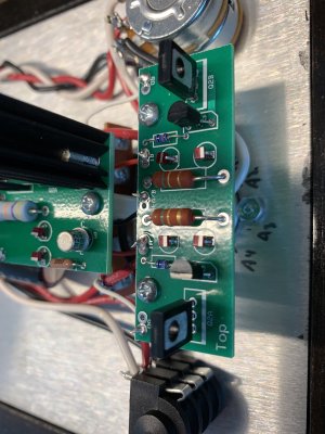

Some pictures of my embarrassing soldering skills attached.
Will reflow solder now and see if that helps.

Just looking at your first photo, I can see down into the holes where the components are installed.  That is indicative that not enough heat has been applied to properly solder these boards.  The solder needs to flow through the board to the other side.
All of the joints on the boards are like this.  You will find that the LEDs and small R1 resistors take the least amount of heat, while the center legs of the MJE350 and TIP50 may need to be heated for 10+ seconds for the solder to flow through to the other side.

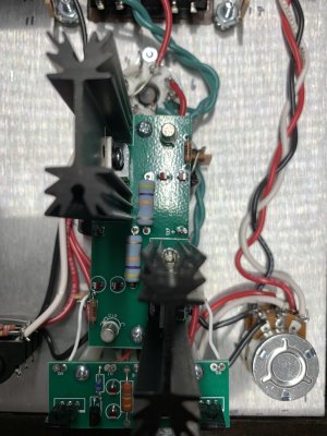

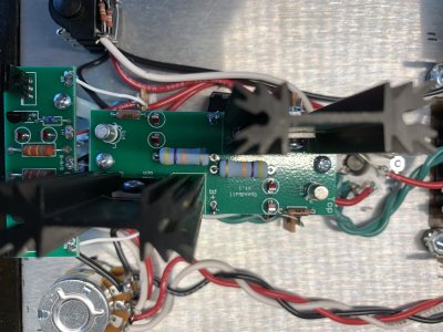

Top View of Large PCB
« Last Edit: December 24, 2020, 08:10:44 AM by awkatche »

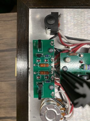

Top View of Small PCB
« Last Edit: December 24, 2020, 08:10:36 AM by awkatche »

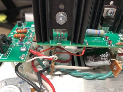

Side view of Large PCB
Aaron K

Reply #13 on: December 24, 2020, 08:09:47 AM

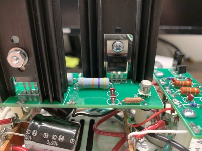

OB Large PCB Connection
Aaron K

The TIP50 transistors still look like they could use some solder.
With some inexpensive headphones plugged into the amp, you can poke around with a wooden chopstick to see if pressing on anything changes the nature of the buzzing, and that could focus your efforts.  The DC voltages you have look OK.
