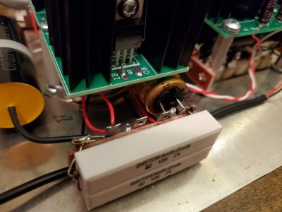

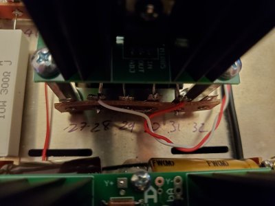

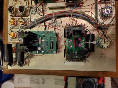

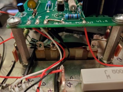

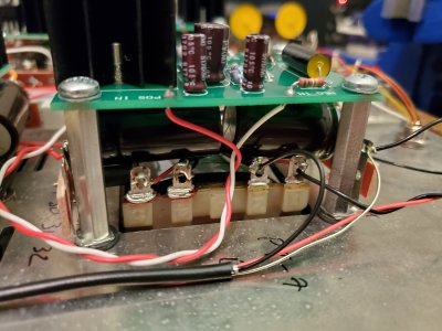

I have built the BeePre a while back and enjoyed it with no issues. Work has been super busy the last couple of months and I hadn't had time to kick back and turn the amp on. I tried turning on everything today and noticed a loud hum in the left channel. It looked like the left 300B tube did not turn on at all. I took some pictures of the left side components.

Offline Kevin
    • Posts: 34
Reply #7 on: January 06, 2021, 07:34:10 PM

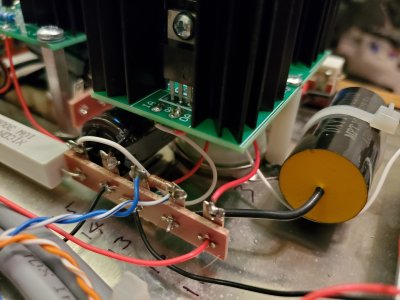

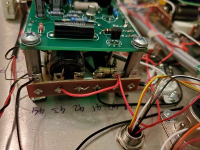

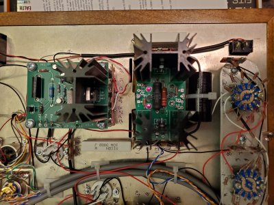

More pics
    • Posts: 20208
Reply #8 on: January 07, 2021, 05:49:06 AM
Pull the filament regulator board on that side and post photos of what's underneath.  The low voltage power supply isn't making it into the board, which could just be something as easy as a loose connection.
Offline Kevin
    • Posts: 34
Reply #9 on: January 07, 2021, 08:52:59 PM
That seemed like the issue.. I unscrewed the board to take some pictures and decided I might as well just flow some solder over all the transformer joints. Nothing really seemed loose, but when I tested the voltages, POS IN was showing 16v and POS OUT was showing 10V. I reconnected the POS OUT wire and rechecked everything and it matched the other side.
All the LEDs turned on and the tube warmed up. Will hook everything back up to my system tomorrow and give it a listen.
