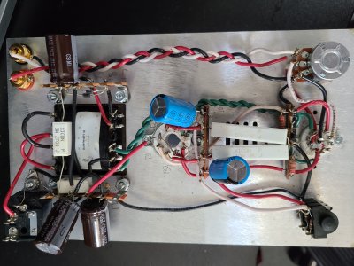

I'm unsure how to proceed with trouble shooting this. I misplaced the PDF of the manual and basically scoured the forum to final a relevant resistance check table for me to add my findings to. I am attaching photos below of the soldering job as well as many photos of the entire build as close up as possible. Any and all help is appreciated.

Are you 100% sure those are all zeroes and not OL?
One wire passing through the earthing lug back by the IEC power entry module isn't captured by solder.  Most of your joints look like they need a significant amount of additional solder and lots more heat.

I see a lot of leads poking out here and there, I would go back in with your needle noise pliers and wrap them over the terminals nice and tightly, then solder between what's wrapped around the terminal and the terminal itself.
I would bet that a proper set of side cutters would help too.  The CHP-170 is what I tend to recommend and they are inexpensive.

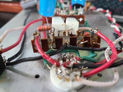

Alright, so I resoldered Terminal 6 at the terminal, terminal 10 at the terminal and terminal 13. I also resoldered the IEC points that were brought up earlier.
https://imgur.com/a/pwsneit
Above are the images.
As an update, 13 climbs to 270K ohms, slowly, but it's inconsistent, sometimes it will drop out, other times it's a steady climb. Terminal 10, when there's initial contact between the red and black wires of the multi meter, provides me with a low resistance of 0.06 and then goes to 0.0 ohms. Terminal 6 remains at OL still, but sometimes 0 based on where I touch it.

12L and 13L look to not have sufficient solder.  Same with 10L.  So let's focus on 10L.  Bend the lead of the banded end of the capacitor up and over the terminal and crimp it onto the terminal strip, then solder to both the terminal strip and the crimped lead.  Repeat that process where you can.

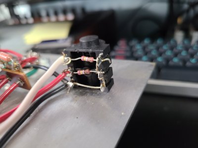

If you don't have 0 ohms at terminal 6 (assuming nothing is plugged into the 1/4" jack), then you have a loose solder joint either at 6 or at the headphone jack.
The solder joint you have at your ground tab right now looks really good.  You want solder joints that look like that everywhere in your amp.

So I think I walked it one step forwards, two steps back. I resoldered Terminals 12,13,10,6, the headphone port that connects to 6 and terminals 2 and 5.
I did 2 and 5 to add more solder at your recommendation, and now terminals 1 2 4 5 have resistances. The vary. but
Terminal 5 is 150K and slowly goes up
Terminal 4 is 100k and slowly goes up
Terminal 3 is 0
Terminal 2 is 79K and slowly goes up
Terminal 1 is 100K and slowly goes up
Terminal 6 is now reading 0
Terminal 10 is now reading 0
Terminal 13 is stably going up
Terminal 12 is 0
Images here: https://imgur.com/a/2chUWdB

1L is very light on solder.
Your resistances look OK though.

So does it look like either 6L or 6U or the corresponding headphone slot need more solder?
I can't see any issues from the photos you posted.
