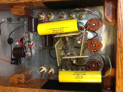

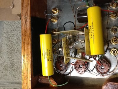

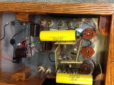

I've recently purchased this Forplay, and gathering info on this site. I still don't know jack.
Can anyone tell me if this is a stock unit ?
The volume pots have no start/stop designations ? Normal ?

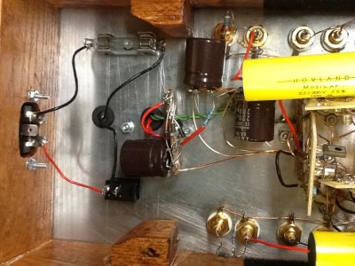

How about the bare wiring I've never seen before ?
Thanks for any assistance.

Looks like the constant current source upgrade is installed, and the Hovland capacitors are nice upgrades.   What appears to be bare wire is actually coated with a clear insulator.    Volume notations are up to you.  Have fun!

There is a special washer with a tab that implements the stop, and it may just be installed upside down - I remember that was a common problem with that kit. It may be possible to fix the lack of a stop.  If not, you might give it a try with  a small input signal, e.g. from a phone or computer output that has the volume turned down and learn where the minimum volume position is - usually straight down. The dual switched controls take some getting used to anyhow. The switched level control was an upgrade kit; the original had two 100K audio-taper potentiometers instead.
There are three input pairs. The original had a single output pair, yours appears to have a second output pair added, perhaps to drive a subwoofer.

What's not stock: the coupling caps, the power supply caps, and the second set of RCA outs.
Everything else looks like it belongs.

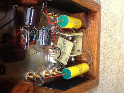

Discovered an issue with my inputs. 1 pair passes signal while 2 do not. The 2 pairs show continuity, and the functioning pair does not ? I've checked and rechecked solder joints and reflowed all. Suggestions ?
Does anyone have a wiring diagram they could send so I can sort out my problem ?
