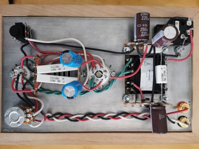

Just got the kit assembled and it passes most resistance check except one - I've got 7.6 ohm - 80 ohm over several re-test (after referring to an old thread where gbennn got 'infinity' on 22, I've since checked through the ground lug, RCA jacks and did some touch up) here's the current measurements I've got:
1. *
2. *
3. 0.6 (my cheap multimeter won't got any lower than that, even with red and black pins touching each other directly 0.6 is the lowest possible)
4. *
5. *
6. 0.6
7. 2.96k
8. 0.6
9. 2.96k
10. 0.6
12. 0.6
13. *
14. 0.6
20. 0.6
22. 15.6 << abnormal
B3. 2.96k
B6. 2.96k
RCA
L - ~100k
R - ~97k
GRN - 0.6
* I have initially painted both side of the transformer bell (was rather careless for not reading through the manual before that), but have since scrapped off the 4 corners where washers are placed, pretty sure it has got clean contact to the bell.
Any pointer to check is very much appreciated, thanks!

That reading at 22 means your transformer screws should be tightened a bit more.
Offline henrywvy
    • Posts: 4
Reply #2 on: January 13, 2021, 05:30:37 PM
Thanks Paul! turns out it's the ground lug that needs to be tightened! wouldn't have guessed that without your expert help, just completed DC check and seems good to go, now I'm excited :D

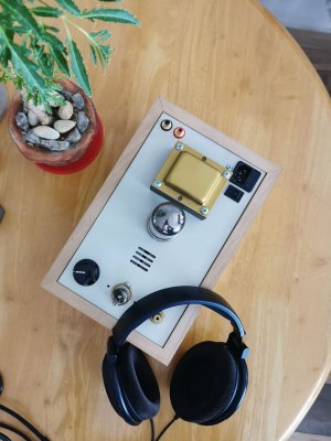

I know I really shouldn't but I ran the voltage test over lunch (working from home) and next thing I know, 1.5 hours had past XD, this does sounds so beautiful with HD6XX/650!
Next I'm looking to treat the wood with boiled linseed oil.

Looks like a very clean and tidy build!
Yes, the non-SB Crack sounds VERY pleasing with the HD600/650's  ;)

Nice looking build!

Thanks a lot for your kind words! was rather nervous as this is the first electronic project for me - only experience with soldering were during high school and that was really a long time ago. This have certainly opened up my mind more and thanks for this wonderful community it's been a very pleasant experience  ;D
Also purchased the SB together, will give the non SB Crack a good time, at least half a year or so before putting that together, though opinions on SB seems to be rather polarized but I guess it deserves a try.

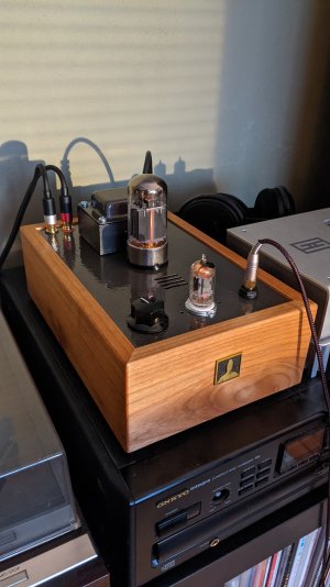

Great looking build! I went the boiled linseed oil route myself and am very pleased with the result. Finished it with Minwax Paste Finishing Wax
