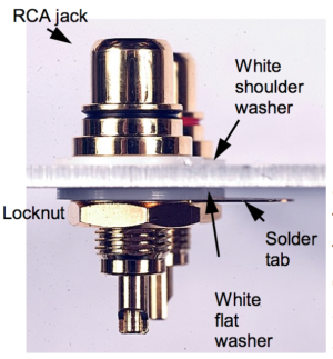

The only possible grounding connection from the ground bus to the chassis is through the RCA jacks. But there are 2 white plastic washers separating the RCA jack from the metal chassis. So the only possible grounding connection is through the physical contact between the RCA cylinders (the portion between the 2 washers) and the RCA holes on the chassis. However, I think that connection might be unstable, because 1.) there is no solid solder connection there; 2.) the physical contact can become loose when temperature changes;  3.) the surface of RCA cylinders & chassis holes can get oxidized over time.

There should be absolutely no contact between the RCA jacks and the chassis plates.  The insulating washers are there to insulate!

Oh...really? Even we put insulating washers there, there will still be contact between the RCA cylinders and chassis holes
No, one plastic washer on each jack has a shoulder to keep it from touching the chassis plate.
But why there should be no contact there, shouldn't the RCA cables be grounded, I didn't get it?  :-[
If you have a connection to the chassis there and the black wire ultimately ending up at 3U, you have two completely different ground paths and you take the chance that you'll end up with ground loop hum.

Reply #11 on: January 23, 2021, 10:06:26 AM
Great, thank you very much for explaining the grounding, PB!
Now I got it why there should be no contact there.
Glad to hear there is a shoulder on the washer to insulate the RCA cylinder. Attention to detail...LOL  ;D
