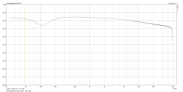

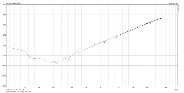

Here's a before and after for a solid state Pioneer amp I recapped playing into a test woofer.  You can definitely hear this!

If you are working with a Class-A amps (runs hot with high, constant current draw), undersized or aged caps will cause audible hum on the speaker because they do not provide enough power supply ripple storage/filtering.
With Class-B amps (typical consumer gear), caps that are too small will cause the amp to not be able to deliver it's rated power output.   This is pretty evident in the images that Paul posted above.
