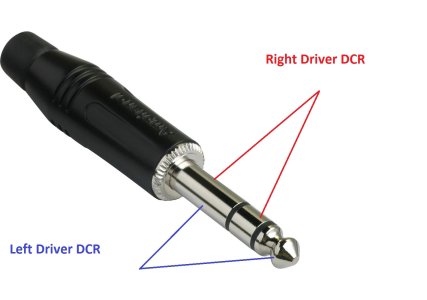

As to why this happens at specific frequencies, that would depend a bit on what's actually going on with the driver.  If you take a DVM and set it to measure DC resistance, what is the DC resistance between the sleeve and the tip vs. the ring and the tip on the headphone plug?

The sleeve to the tip is ~1000 ohm and the ring to the tip is above 200M as it just overshoots the voltmeter.  The two black wires on the headphone jack do look loose, so you think that connection might have done it?

No, I mean unplug your headphones and measure the impedance of the actual drivers of the headphones themselves, unless you have super duper high impedance headphones?

No, I'm hoping you will measure the DCR of the headphones you have that are damaged.

Measure resistance (ohms) between (a) tip and sleeve, and (b) ring and sleeve.  See if they match.
